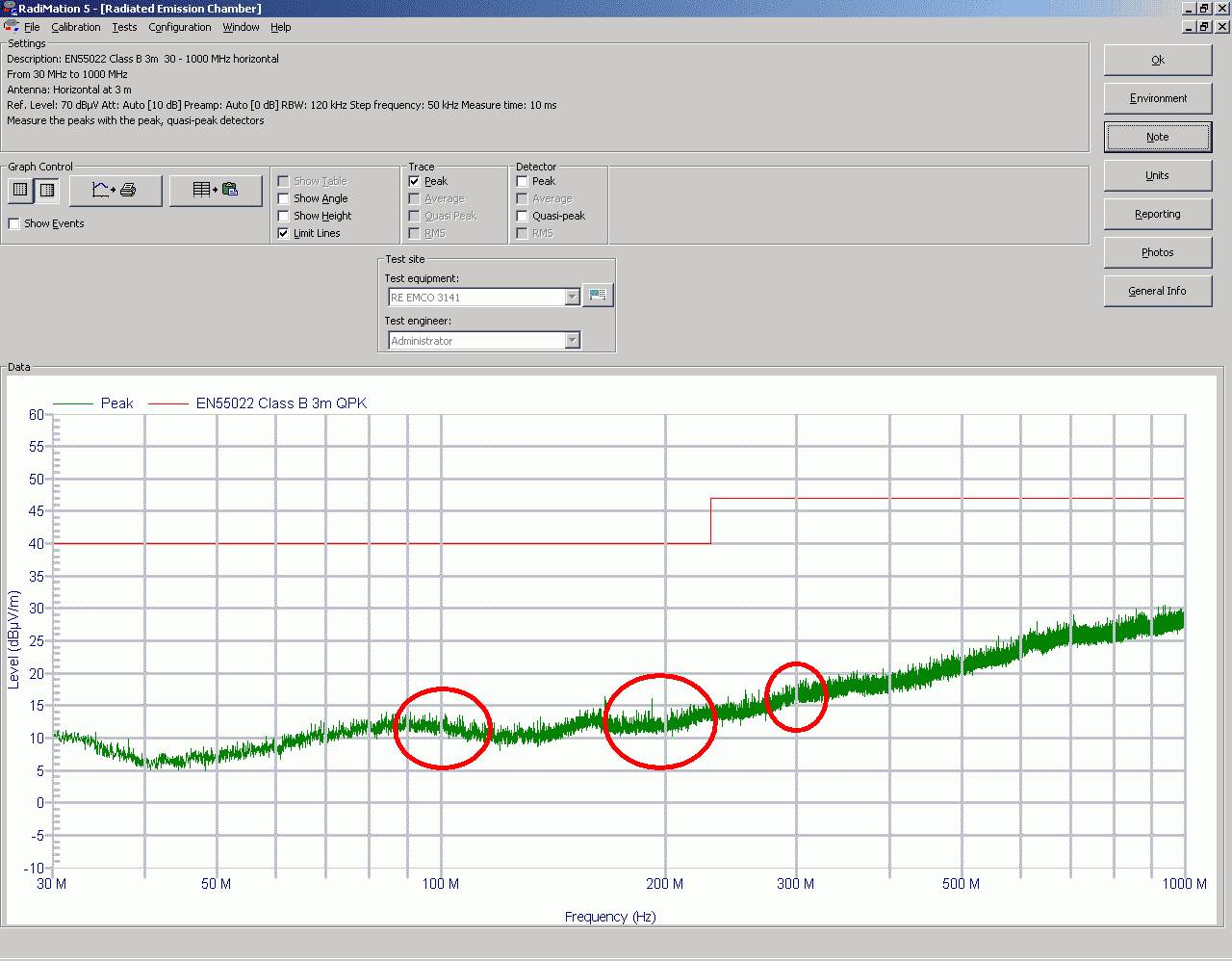

While performing emission measurments with Radimation 5.8.16, the vertical lines of the graph obstruct the measurement values.
The representation of horizontal lines is correct, behind the measurement graph.
The vertical lines should fall behind the measurement graph not in front.
CAn this be solved by changing parameters or is this a bug in RadiMation 5.8.16?
See attached graphs.
Vertical graphlines obstruct measurement result.

It is indeed correct that the vertical graphlines are positioned on top of the measurement results. This was already known to us, but it was never pointed out to be a serious problem.
Your attachment however shows that this can result in incorrect results when a narrow emission is precisely on a 'nice' frequency (like the 200 MHz signal in your plots).
We are using a powerful third-party graphing module, but this module cannot show the vertical grid lines in the way we want. The vertical grid lines are therefor internally 'simulated' by drawing additional annotations that look like vertical gridlines. These annotations are however positioned on top of the measurement graphs, and therefor they could hide the measurement results.

While performing emission measurments with Radimation 5.8.38, the vertical lines of the graph still obstruct the measurement values.
See attachment.
In my opinion this should be solved in the newer versions of RadiMation.
Could you please provide information regarding the RadiMation version when you expect this should be solved?
See attachment.

The problem where the graphlines of a graph are drawn behind the grid lines of the graph has been fixed in version 2012.1.6 of RadiMation.
Due to other issues, that RadiMation version hasn't been released in the past.
Today we released version 2013.1.6 of our RadiMation software, which fixes your problem. This new version can be downloaded from our webshop. (see: viewtopic.php?f=3&t=53 )
