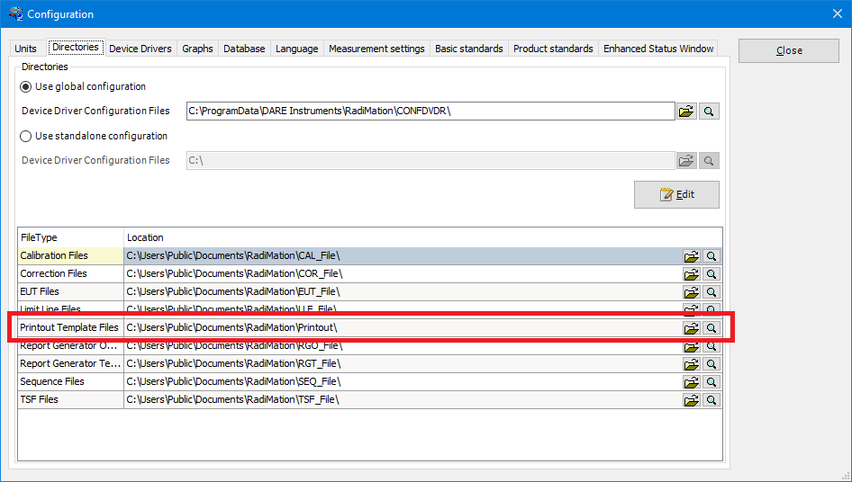

The location of the 'Printout' templates can be found by checking the directory that is specified for the 'Printout Template Files' on the 'Directory' tab of the RadiMation configuration window.
Printout template directory selection on the RadiMation configuration window
The magnifier button can be used to very easily open the specified directory in the Windows Explorer.
The files in this directory all have a specific name, that determines which file is used, when something is printed from within RadiMation.
