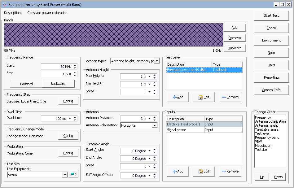

  2. Configure a Multiband Radiated Immunity test to generate a fixed power level over the required frequency range, while an electrical field probe is used to measure the generated field. For example:
    • 1% logarithmic frequency step
    • A short dwell time (for example 100 ms)
    • Constant frequency change mode
    • No modulation
    • A single antenna height
    • Horizontal or Vertical polarization
    • A single turntable angle
    • A fixed forward power test-level (a 'power closed loop method') with the to be generated power level.
    • Signal power measurement as an input
    • Electrical field probe measurement as an input
    Example of the configuration of a constant power TSF

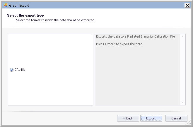

  8. Select 'CAL-file' as the type of the file to which the graphline should be exported, then click the 'Export' button

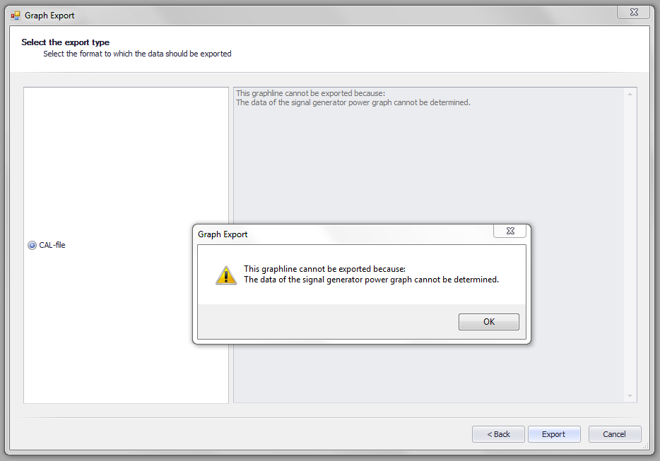

I get an error when exporting the CAL file (step 7) when I press Export: "This graphline cannot be exported because: The data of the signal generator power graph cannot be determined." Any suggestions?
Screenshot error
Screenshot error

For a Calibration file it is required that the Signal generator power is available.
During the exporting of a graphline, a lot of validations are performed, and the shown error message is an indication that the no signal power graphline was present in the performed test.
It seems that the test you performed is not configured to measure the signal geneator power.

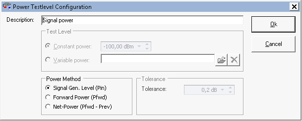

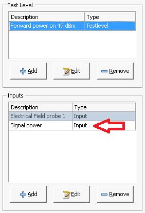

Please go back to configuration of the 'constant power calibration method' test, and add a 'Power' input, where the 'Power Method' is set to 'Signal Generator level'.
Power input configuration for the measurement of the signalpower
With this improved test configuration, the test will also measure the signal generator power, and it will be possible to export the data to a Calibration file.

Thanks for the quick reply. Indeed the 'Power Method' was set to 'Forward Power' instead of 'Signal Generator level'. This adjustment solved the error and exported the Calibration file without any problems.

The 'signal power' and other power graphlines can only be exported if a graphline is available for it. This is not necessary, but if you want to review or export this information also, it is best to specify a 'Signal power' and/or a 'Forward power' input in the Mulitband test configuration. Once one or more of those inputs is configured, a graphline will be created for it, and it is possible to review or export it.
