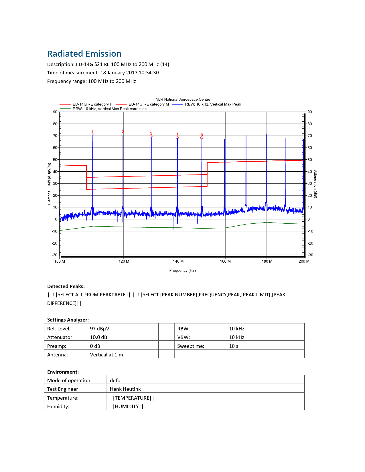

Printout of redused emission (peak) table
Want to make a peak table with redused column information. The keyword "EMISSION TABLE" is working. Can't find the correct keywords to generate this table. What is wrong in the keywords beneath (see file attachment).

Thanks for the code. However it stills not working. The complete table is written to the generated report document.
Attached two files:
Template document as input for report generator: REmultiband.docx
Generated report document: 6143301.4.1.1.docx
Also during generation of the report the report generator complains about keyword "". I just skipped it during report generation. What could this be, i can't find it in the template document.

The select command can be used to print the full table:
||SELECT ALL FROM PEAKTABLE||
Or selecting only a few columns:
||SELECT [PEAK NR],FREQUENCY,PEAK,[PEAK LIMIT],[PEAK DIFFERENCE] FROM PEAKTABLE|| ||RUNMACRO(AUTOFITTHISTABLE)||
The second table code in your template does not contain the: "FROM PEAKTABLE||" part.
I have placed the Table code in a Word table so the generator will make a table with lines in it. See attached modified template.
